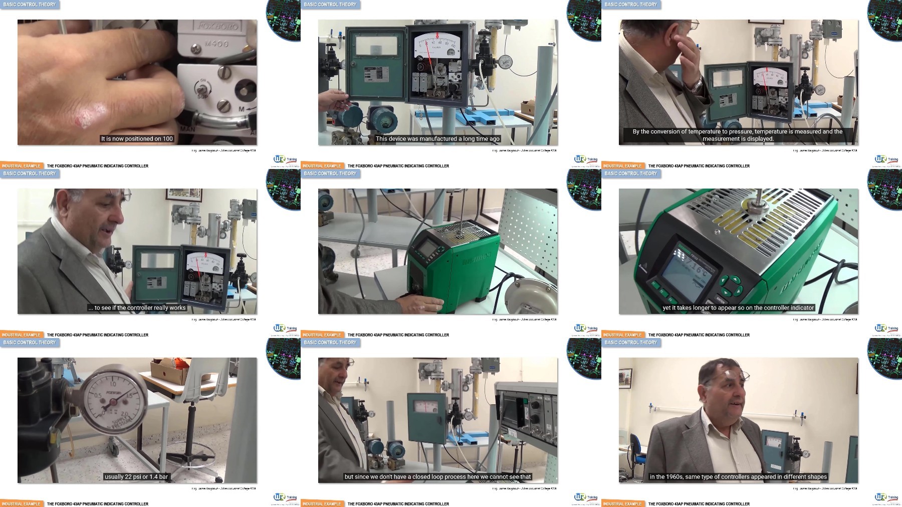

Lecture 19 Industrial Example - The FOXBORO 43AP Pneumatic Indicating Controller
