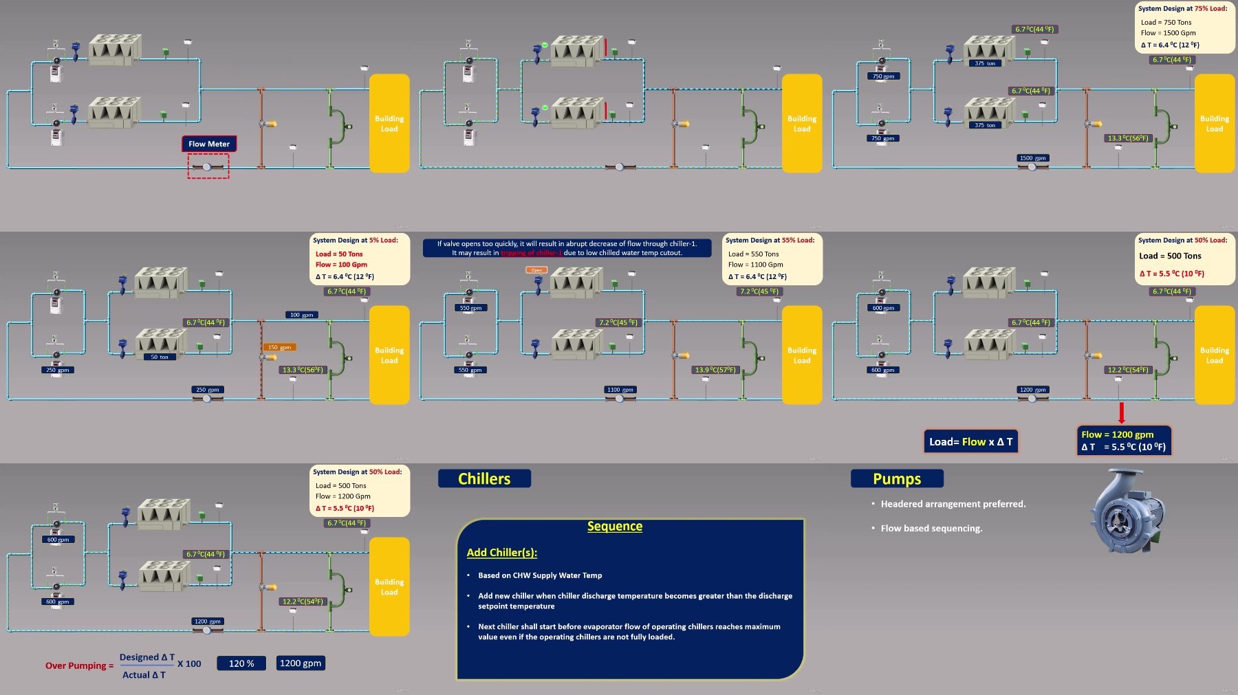

Lecture 49 Constant Primary Chilled Water System
Lecture 50 Primary Secondary Chilled Water System
Lecture 51 Variable Primary Flow(VPF) Chilled Water system
