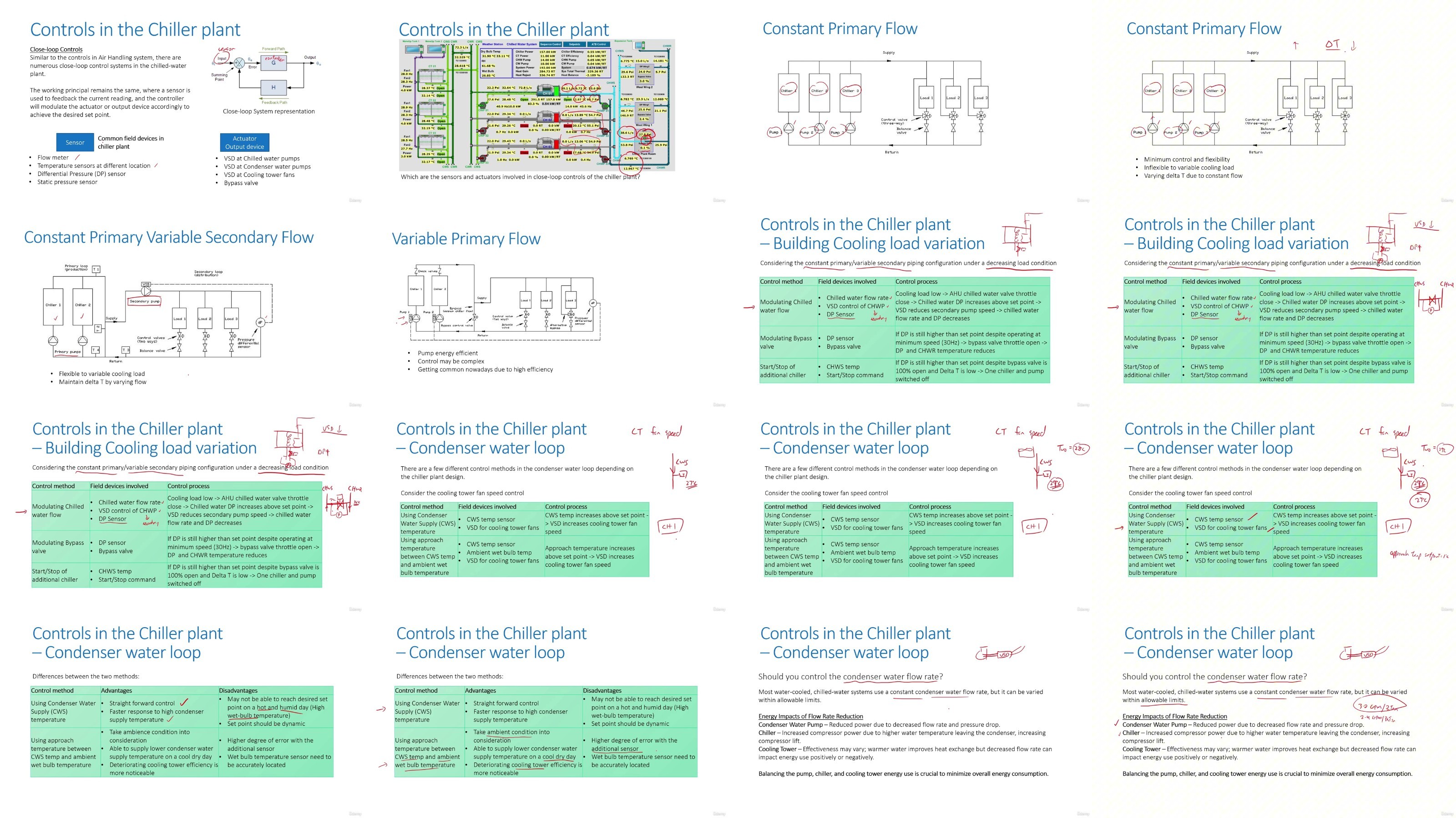

Understand basic controls in the air distribution system and chiller plant using Building Management System (BMS)

In addition, you will gain knowledge in HVAC controls (air-side and water-side) and troubleshooting using Building Management System. This is usually overlooked and is often handled by automation engineer. Good controls are important in managing the HVAC system effectively and in optimizing the operation of the whole chiller plant. Join me in this unique course to give yourself a head start in the HVAC career!

Explain controls in chiller plant (water-side)
