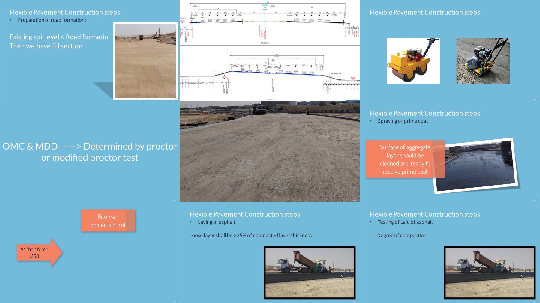

Structural design of asphaltic pavement
understanding the component of flexible pavement
understanding the method of constructing a flexible pavement
understanding what is the traffic survey and vehicle classification
Determining the ESWL for different axle configurations
learning how to design pavement structure and determine pavement layers thickness by CBR design method
Learn how to determine EALF, TF
Determining the ESAL by analyzing the traffic survey data
understanding the concept of the equivalent axle load and the method of calculating ESAL
learning how to design pavement structure and determine pavement layers thickness by AASHTO design method
No pre-requirement
This course will discuss several important subjects for road Engineers. This course will discuss mainly the method of designing the structure of a pavement. The design of a pavement structure means determining the layers of a pavement, furthermore, determining the thickness of each layer. The purpose of a structural design of Pavement is to determine the suitable pavement to sustain a specific traffic volume for the design period. In this course, you will learn the design of Pavement by the use of CBR method and AASHTO method. The design of Pavement by the use of AASHTO method will include determining a set of parameters such as ESWL which is a number calculated to represent the traffic carried by the pavement during the design life, also, resilient modules, reliability, standard deviation and other parameters are determined to calculate the structural numbers of different pavement layer. SN is used to determine the thickness of different pavement layers. You will see the process of determining all these parameters to find the thickness of Pavement layers. This course will include a various examples to simplify and enhance the understanding process. Also, it will include quizzes and assignments.This course will also briefly explain the construction of a pavement and the component of a flexible pavement. This course will briefly discuss the procedures of constructing Embankment, laying and compaction of granular subbase and roadbase layers. Also, the procedure of laying asphalt and the types of asphaltic concrete courses. In conclusion, this course will focus on designing and construction of a flexible pavement. At the end of this course, you should have a sufficient knowledge of how the pavement is constructed, the different pavement layers and properties of each layer. Also, how to design a pavement and how to analyze the traffic survey data to determine the ESAL and then determining the thickness of different pavement layers.

Lecture 1 Flexible and rigid pavement
Section 2: flexible pavement layers
Lecture 2 Introduction: Flexible pavement layers
Lecture 3 CBR Test
Lecture 4 Subgrade and improved subgrade
Lecture 5 Aggregate Subbase
Lecture 6 Wet Mix-Macadam
Lecture 7 Aggregate Road-base
Lecture 8 Prime coat
Lecture 9 Asphaltic concrete courses
Lecture 10 Construction of road pavements
